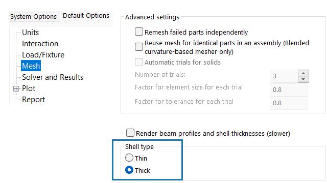

You can assign the shell type definition, Thick or Thin globally, for new studies.
To modify the Shell type, from the menu at the top bar, click Simulation > Options... > Default Options > Mesh. The specified shell type applies to new shell definitions created from surface bodies, sheet metal bodies, and solid bodies using the Define shell by selected face command.
