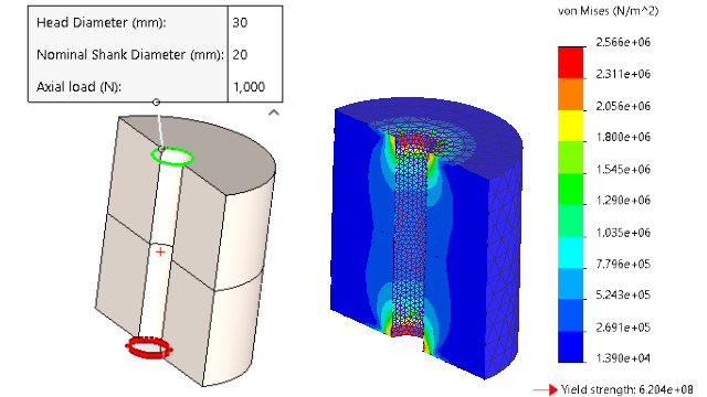

  • Intel Direct Sparse solver. Models that previously failed to solve because of limitations on the number of coupling facets (surface elements) exceeding 800 can reach a solution. This restriction is removed. In addition, solution time for models using connectors with distributed coupling and a large number of coupling nodes (for example, bolt, bearing, and linkage rod connectors) is faster.
    For example, the image above shows a model of two cylinders that are attached with a bolt with distributed coupling. In earlier releases, the linear static study of this model failed because of the limitation on the number of coupling facets. In this release, the Intel Direct Sparse solver successfully provides a solution for the same study.
