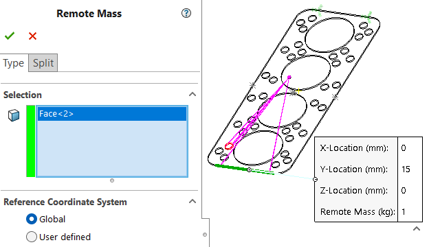

Response spectrum analysis studies support the application of remote masses.
You can include the effect of a component's mass that is not part of the meshed geometry to the rest of the model by treating it as a remote mass. To apply a remote mass to a model for which you want to run a response spectrum analysis, from the simulation study tree, right-click External Loads, and select Remote Mass . Specify the location of the remote mass at the component's center of gravity. The remote mass is rigidly connected to the rest of the model at the selected faces, edges, or vertices.
