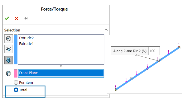

Applied Forces on Beams
You have more flexibility when applying forces on beam bodies.
In earlier releases, you could only apply a force load to beam bodies with the default option Per item. In this release, you can select the Total option in the Force/Torque PropertyManager to distribute a force load among several beam bodies that is proportional to their lengths.
