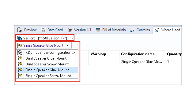

You can view
configurations of part or assembly files when you select All
Versions in the Where Used
tab.
The list contains
all configurations across all versions of the selected file to which you have access
permission. From the list, select a Configuration
to view its references.
