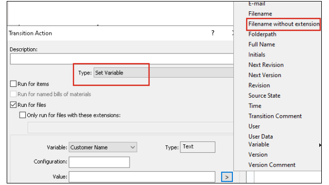

SOLIDWORKS PDM 2022
has new APIs and
other
improvements.
- You can save a card that has more than 2000 characters in an alias in an input
formula.
- In the Transition Action dialog box,
when you
specify
Type as Set
Variable, you can define the value of the selected variable as
Filename without extension.
