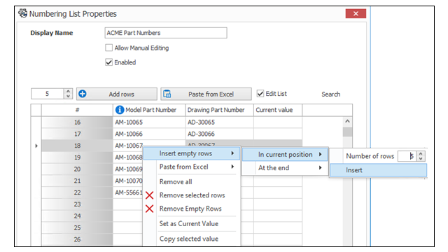

Numbering Lists
Numbering Lists lets you assign part numbers to SOLIDIWORKS files.
Administrators can add a series of numbers to a list. When the users save a new file into a document object, instead of using the Numbering Scheme, they can use the new number in the list.
It is easier to integrate parts numbers:
  • That you receive from a third party.
  • For models and drawings that do not follow sequential numbering.
