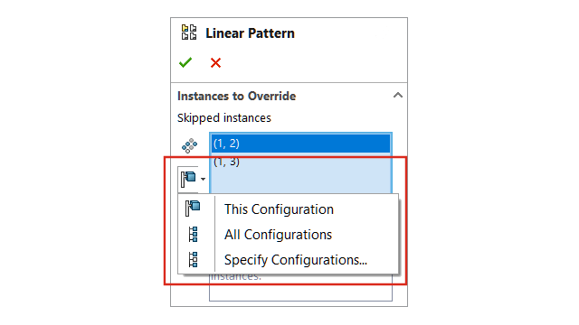

You
can select This Configuration
, All
Configurations
, or Specify Configurations
for skipped instances in assembly
component patterns.
The
configuration option is available for
these
assembly component patterns:
- Linear Component Pattern
- Circular Component Pattern
- Pattern Driven Component Pattern
- Sketch Driven Component Pattern
- Curve Driven Component Pattern
In a design table, you can use $skip@<type of
pattern><number>
to specify skipped instances. For example, $skip@Lpattern1
. If there is more than one skipped instance, use a
semicolon to separate values. For example: 10,1;10,2;
To select a configuration for skipped
instances:
- Open a model with multiple configurations and edit a pattern
feature.
- In the PropertyManager, select an instance to skip and select
This Configuration
, All Configurations
