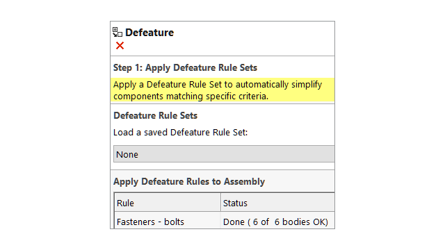

Using the Defeature Silhouette method, you can create a set of rules to
simplify the components in a model. You can specify criteria for component selection,
defeature method, and a defeature orientation. You can
enclose
the components in one body and propagate visual properties.
For example, you can create a rule to
simplify fasteners as cyclinders when the filename for a fastener contains bolt, nut, or
washer.
You can save the
rule set to use with other models. You can specify a file location for saved rule sets.
You can use a rule set with a defeature group to defeature a
model.
