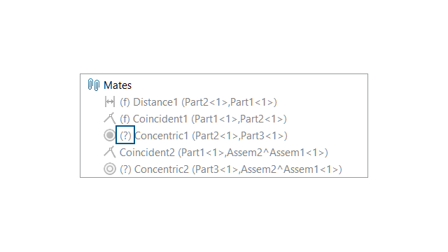

Unsolved Prefix Displays for Suppressed Mates (2024 SP2)
In a model, the unsolved prefix (?) displays in the mate name when a suppressed mate has a missing reference.
To view the unsolved prefix:
  1. Open a model that has a suppressed mate with a missing reference.
  2. In the FeatureManager design tree, expand the Mate folder.
    The unsolved prefix (?) shows in the mate name.
