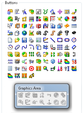

The Customize dialog box opens to the Commands tab.
Below the Buttons area on the right side of the dialog box, a box appears with the default context toolbar buttons shown as unavailable. You cannot remove or reorder the default buttons.
The label of the box indicates whether you displayed the context toolbar from the FeatureManager design tree or the graphics area.
- Select a command category.
- Under Buttons, drag a toolbar button to the toolbar.
The software places the button after the default buttons.
