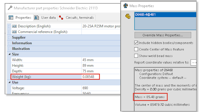

You
can manage the weight of
a
manufacturer part.
The weight
propagates to the Mass properties of the 3D
assembly associated with the component on which you assign the manufacturer part. For
components
that are cut, like
rails
or
ducts,
the weight updates according to the Depth value
that you use in the cabinet layout.
