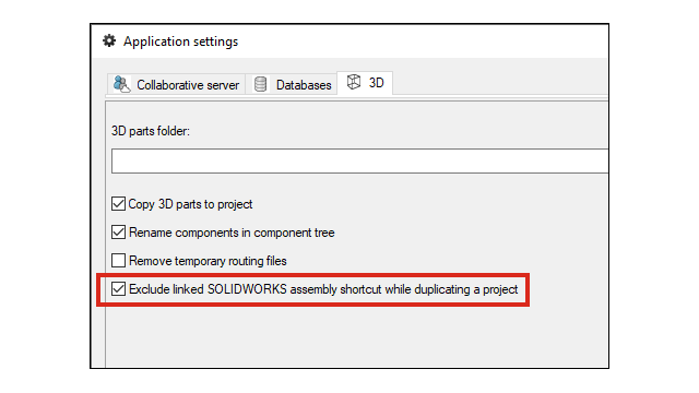

When you duplicate a project, you can remove the link of the
SOLIDWORKS assembly to its original path.
To remove the link, from , select Exclude linked SOLIDWORKS assembly
shortcut while duplicating a project.
To relink an existing assembly file inside a project to another already
existing SOLIDWORKS assembly, you can browse and select the new SOLIDWORKS assembly from
the
Creation of assembly files dialog box. SOLIDWORKS Electrical
retains the association of the 3D components after you select an existing assembly file
from the required location if the same 3D part files are found. Previously, it was
impossible to relink the existing SOLIDWORKS assembly file in a duplicated project to a
new SOLIDWORKS assembly.
This is available only for the SOLIDWORKS
Electrical 3D add-in.
