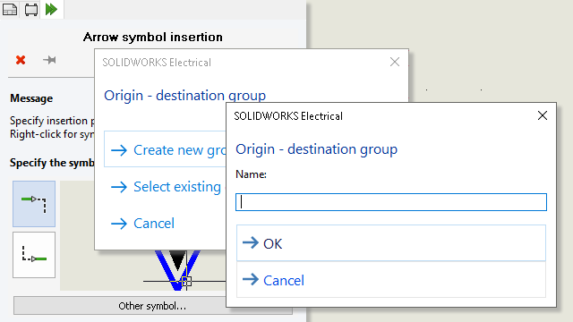

You
can manually insert
origin-destination
arrow symbols at the end of the wires. You associate a group number with each inserted
symbol. All the wires connected on the same group number have the same equipotential
number.
To insert
an
origin-destination
symbol, click .
