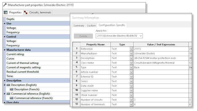

For each component, you can propagate the electrical properties to
the 3D part or assembly.
If you modify the electrical properties in
the 2D application, you must click Update BOM Properties in the
SOLIDWORKS Electrical menu, to update the 3D part properties.
You can use these properties to complete
tables like the Bill of Materials.
