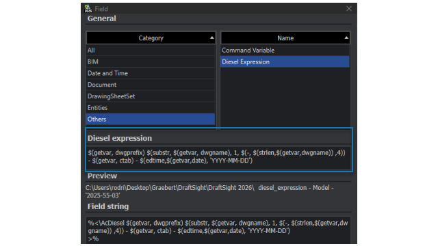

The FIELD command supports Diesel Expressions, enabling dynamic text that automatically updates based on drawing properties or user inputs.
You can create custom text fields that concatenate strings, perform calculations, and apply conditional formatting without needing external scripts or complex programming. This improves automation and flexibility when working with text data in drawings.
To use the FIELD command:
Do one of the following:
  • On the ribbon, click Insert > Data > Field.
  • On the menu, click Insert > Field.
  • Enter FIELD in the command window.
