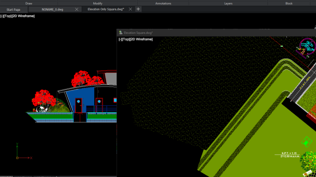

Floating Document Windows (DraftSight Premium Only)
With floating document windows, you can open drawings in separate windows outside the main application in DraftSight Commander. The windows offer flexible views of multiple drawings side-by-side or across multiple monitors. This functionality provides additional workflow options and enhances productivity by facilitating comparisons, copying and pasting, and multitasking.
To create a floating document window, drag a document tab outside the main window. The floating document window operates independently; you can adjust its size, zoom, and navigate as required.
