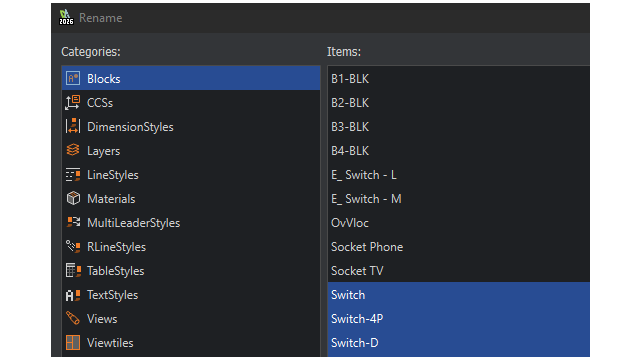

RENAME Command
The RENAME command supports wildcard characters, making it easier to find and rename multiple named elements at once. You can filter matching items in the RENAME dialog box and rename multiple objects more efficiently.
To use the RENAME command:
Do one of the following:
  • On the menu, click Format > Rename.
  • Enter RENAME in the command window.
