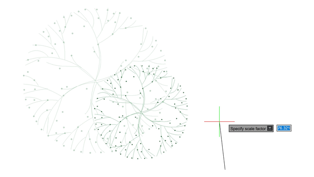

Copying with SCALE Command
The SCALE command includes a Copy option. With this option, you can preserve the original entities while generating scaled duplicates.
The Copy option provides a more streamlined and efficient process. Previously, you had to use the COPY command before the SCALE command to copy entities.
To use the SCALE command:
Do one of the following:
  • On the ribbon, click Home > Modify > Scale.
  • On the menu, click Modify > Scale.
  • Enter SCALE in the command window.
