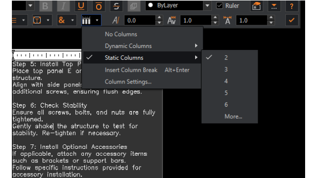

You can create and edit multiple columns within MTEXT entities. With the in-place text editor, you can add columns with equal widths and consistent gutters (spaces between columns), and adjust the height with grips.
Columns are beneficial for complex documentation or design notes because they help you organize multicolumn text into clearly structured, easy-to-read layouts. They also maximize the available workspace by efficiently managing text within drawings.
