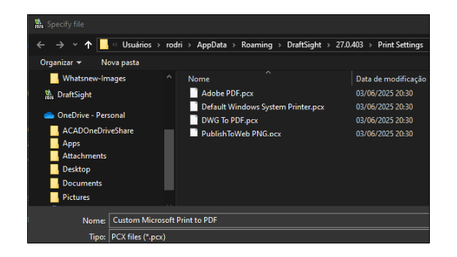

PCX Print Configuration Files (DraftSight Premium Only)
DraftSight supports .PCX print configuration files, providing functionality similar to the .PC3 format in other CAD software.
You can import .PC3 files or create and save new print configuration files in the .PCX format. The .PCX format makes it easier to reuse and share print settings for consistent output across multiple print jobs. This improves workflow efficiency by ensuring standardized print configurations.
To use .PCX print configuration files:
Do one of the following:
  • On the ribbon (Application menu), click Print > Print.
  • On the menu, click File > Print.
  • Enter PRINT in the command window.
  • Keyboard shortcut: CTRL+P.
