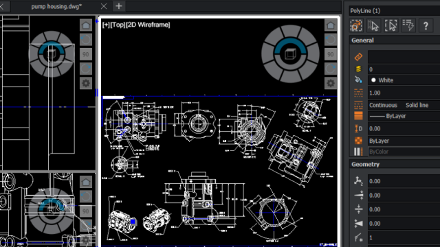

Manipulating ViewTiles (DraftSight Premium Only)
You can resize ViewTiles by adjusting boundaries, merge ViewTiles when boundaries align, and create new ViewTiles with one click or using CTRL+drag.
Resizable ViewTiles have adjustable markers and snap-to-boundary alignment, and allow resizing of connected tiles. DraftSight allows flexible arrangements (one-to-one, one-to-multiple, and multiple-to-multiple configurations), and all actions support Undo/Redo for corrections.
