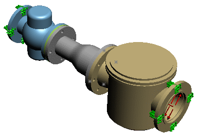

The components of a piping assembly are subjected to a high internal pressure load. You define two sets of bolt connectors and check which bolts can safely carry the load, and which will fail.
In this tutorial, you learn how to:
  • Define bolt connectors in a hole series.
  • Run a pass/no pass check for connectors.
